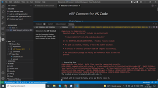

  • as you says i change the file location
    but error still appearing
    CMake Error in CMakeLists.txt:
    No CMAKE_CXX_COMPILER could be found.
    Tell CMake where to find the compiler by setting either the environment
    variable "CXX" or the CMake cache entry CMAKE_CXX_COMPILER to the full path
    to the compiler, or to the compiler name if it is in the PATH.
    See also "C:/Users/mohit/ncs/bsec_integration/build/CMakeFiles/CMakeOutput.log".
    See also "C:/Users/mohit/ncs/bsec_integration/build/CMakeFiles/CMakeError.log".
    FATAL ERROR: command exited with status 1: 'c:\Users\mohit\ncs\v1.9.1\toolchain\opt\bin\cmake.EXE' '-DWEST_PYTHON=c:\Users\mohit\ncs\v1.9.1\toolchain\opt\bin\python.exe' '-Bc:\Users\mohit\ncs\bsec_integration\build' '-Sc:\Users\mohit\ncs\bsec_integration' -GNinja -DBOARD=thingy91_nrf9160 -DCMAKE_EXPORT_COMPILE_COMMANDS:BOOL=On -DNCS_TOOLCHAIN_VERSION:STRING=NONE -DCONFIG_DEBUG_OPTIMIZATIONS=y -DCONFIG_DEBUG_THREAD_INFO=y
    The terminal process terminated with exit code: 1.

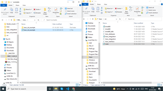

  • Sir now i explain situation step by step. in odder to interface with BSE i have taken following step . Please correct me where i was wrong .

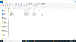

    Step 1:   Download library from  https://www.bosch-sensortec.com/software-tools/software/bsec/ offical ink on nrodic site.
    Step 2: after extracting the file . i have created a folder in name" bsec"  you can see the path in image

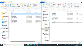

    Step3: copy file from bsec_ito_example (1LHS) to scr folder of my "bsec" fle(2RHS)
                ( 1 )                                                              (2)
    Step4: change name from of  "bse_ito_example " which contain the main code (1)
    copy and rename in my application folder(2)     (i add zephyr library for print_k in main file , remain code is same )
                    (1)                                        (2)

    [161/174] Linking C executable zephyr\zephyr_pre0.elf
    FAILED: zephyr/zephyr_pre0.elf zephyr/zephyr_pre0.map
    cmd.exe /C "cd . && C:\Users\mohit\nrf\v1.9.1\toolchain\opt\bin\arm-none-eabi-gcc.exe   zephyr/CMakeFiles/zephyr_pre0.dir/misc/empty_file.c.obj -o zephyr\zephyr_pre0.elf  -Wl,-T  zephyr/linker_zephyr_pre0.cmd  -Wl,-Map=C:/Users/mohit/nrf/v1.9.1/Nordic_Acadmey/bsec/build/zephyr/zephyr_pre0.map  -Wl,--whole-archive  app/libapp.a  zephyr/libzephyr.a  zephyr/arch/common/libarch__common.a  zephyr/arch/arch/arm/core/aarch32/libarch__arm__core__aarch32.a  zephyr/arch/arch/arm/core/aarch32/cortex_m/libarch__arm__core__aarch32__cortex_m.a  zephyr/arch/arch/arm/core/aarch32/cortex_m/cmse/libarch__arm__core__aarch32__cortex_m__cmse.a  zephyr/arch/arch/arm/core/aarch32/mpu/libarch__arm__core__aarch32__mpu.a  zephyr/lib/libc/minimal/liblib__libc__minimal.a  zephyr/lib/posix/liblib__posix.a  zephyr/soc/arm/common/cortex_m/libsoc__arm__common__cortex_m.a  zephyr/boards/boards/arm/thingy91_nrf9160/lib..__nrf__boards__arm__thingy91_nrf9160.a  zephyr/drivers/clock_control/libdrivers__clock_control.a  zephyr/drivers/console/libdrivers__console.a  zephyr/drivers/gpio/libdrivers__gpio.a  zephyr/drivers/i2c/libdrivers__i2c.a  zephyr/drivers/serial/libdrivers__serial.a  zephyr/drivers/timer/libdrivers__timer.a  modules/nrf/lib/fatal_error/lib..__nrf__lib__fatal_error.a  modules/nrf/drivers/hw_cc310/lib..__nrf__drivers__hw_cc310.a  modules/hal_nordic/nrfx/libmodules__hal_nordic__nrfx.a  -Wl,--no-whole-archive  zephyr/kernel/libkernel.a  zephyr/CMakeFiles/offsets.dir/./arch/arm/core/offsets/offsets.c.obj  -L"c:/users/mohit/nrf/v1.9.1/toolchain/opt/bin/../lib/gcc/arm-none-eabi/9.2.1/thumb/v8-m.main/nofp"  -LC:/Users/mohit/nrf/v1.9.1/Nordic_Acadmey/bsec/build/zephyr  -lgcc  zephyr/arch/common/libisr_tables.a  C:/Users/mohit/nrf/v1.9.1/nrfxlib/crypto/nrf_cc310_platform/lib/cortex-m33/soft-float/no-interrupts/libnrf_cc310_platform_0.9.13.a  -no-pie  -mcpu=cortex-m33  -mthumb  -mabi=aapcs  -mfp16-format=ieee  -Wl,--gc-sections  -Wl,--build-id=none  -Wl,--sort-common=descending  -Wl,--sort-section=alignment  -Wl,-u,_OffsetAbsSyms  -Wl,-u,_ConfigAbsSyms  -nostdlib  -static  -Wl,-X  -Wl,-N  -Wl,--orphan-handling=warn && cmd.exe /C "cd /D C:\Users\mohit\nrf\v1.9.1\Nordic_Acadmey\bsec\build\zephyr && C:\Users\mohit\nrf\v1.9.1\toolchain\opt\bin\cmake.exe -E echo ""
    c:/users/mohit/nrf/v1.9.1/toolchain/opt/bin/../lib/gcc/arm-none-eabi/9.2.1/../../../../arm-none-eabi/bin/ld.exe: app/libapp.a(bsec_integration.c.obj): in function `bme680_bsec_update_subscription':
    C:\Users\mohit\nrf\v1.9.1\Nordic_Acadmey\bsec\src\bsec_integration.c:140: undefined reference to `bsec_update_subscription'
    c:/users/mohit/nrf/v1.9.1/toolchain/opt/bin/../lib/gcc/arm-none-eabi/9.2.1/../../../../arm-none-eabi/bin/ld.exe: app/libapp.a(bsec_integration.c.obj): in function `bme680_bsec_process_data':
    C:\Users\mohit\nrf\v1.9.1\Nordic_Acadmey\bsec\src\bsec_integration.c:417: undefined reference to `bsec_do_steps'
    c:/users/mohit/nrf/v1.9.1/toolchain/opt/bin/../lib/gcc/arm-none-eabi/9.2.1/../../../../arm-none-eabi/bin/ld.exe: app/libapp.a(bsec_integration.c.obj): in function `bsec_iot_init':
    C:\Users\mohit\nrf\v1.9.1\Nordic_Acadmey\bsec\src\bsec_integration.c:186: undefined reference to `bsec_init'
    c:/users/mohit/nrf/v1.9.1/toolchain/opt/bin/../lib/gcc/arm-none-eabi/9.2.1/../../../../arm-none-eabi/bin/ld.exe: C:\Users\mohit\nrf\v1.9.1\Nordic_Acadmey\bsec\src\bsec_integration.c:207: undefined reference to `bsec_set_state'
    c:/users/mohit/nrf/v1.9.1/toolchain/opt/bin/../lib/gcc/arm-none-eabi/9.2.1/../../../../arm-none-eabi/bin/ld.exe: C:\Users\mohit\nrf\v1.9.1\Nordic_Acadmey\bsec\src\bsec_integration.c:196: undefined reference to `bsec_set_configuration'
    c:/users/mohit/nrf/v1.9.1/toolchain/opt/bin/../lib/gcc/arm-none-eabi/9.2.1/../../../../arm-none-eabi/bin/ld.exe: app/libapp.a(bsec_integration.c.obj): in function `bsec_iot_loop':
    C:\Users\mohit\nrf\v1.9.1\Nordic_Acadmey\bsec\src\bsec_integration.c:539: undefined reference to `bsec_get_state'
    c:/users/mohit/nrf/v1.9.1/toolchain/opt/bin/../lib/gcc/arm-none-eabi/9.2.1/../../../../arm-none-eabi/bin/ld.exe: C:\Users\mohit\nrf\v1.9.1\Nordic_Acadmey\bsec\src\bsec_integration.c:521: undefined reference to `bsec_sensor_control'
    FATAL ERROR: command exited with status 1: 'c:\Users\mohit\nrf\v1.9.1\toolchain\opt\bin\cmake.EXE' --build 'c:\Users\mohit\nrf\v1.9.1\Nordic_Acadmey\bsec\build'
    Terminal will be reused by tasks, press any key to close it.
