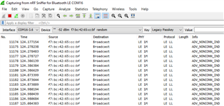

scan_adv example - why it is discovered multiple times?
Hello, All

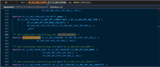

I am trying the scan_adv example, and use my phone to scan the advertising packet, unlike other peripheral examples, I found that it appears multiple time with different MAC address, is this expected? In order to scan it easily, I added a device name and flag in the adv packet.
I use nrf connect SDK and VS code. I use  nRF connect Mobile app to do scan.
Thanks you.

  • Thank for your reply, Amanda
    Yes, I am talking about advertiser's MAC address.
    So, it is normal for MAC address to be changed like the example above? I don't think I have reset it when i see it multiple times with different MAC address.
    I am developing a central scan application, and would like to use MAC address as peripheral's ID, if it is keeping changing, then i would have received a lot of them without knowing they are from same device, is this right? how common the MAC address keep changing on fly?
