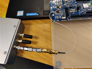

What we have done for now is what you can see in this picture.
In the picture you can see the development master to the left, hooked up to 3 10 db attenuators and to that, a male to male converter hooked up to a wire that goes to the u.FL slot on the nrf52840. Initially the master had 3 antennas, we identified that one seems to be more operational then the other and therefore we removed that one and hooked it up this way.
We have done this to minimize interference and to try to monitor everything that is being sent out from the master. We are not sure if this setup is working and what the difference is between an external and internal antenna on the nrf52840 (if there even is one).

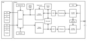

We also dont know if the radio sample that we are using is picking up these packets that the master is sending out, we know that the master is sending out a bunch of stuff but we are unsure if these packets are ending up on the u.FL slot, if they are, they are most certainly discarded by the radio infrastructure within the nrf52840 since its designed for BLE packets and NOT IO-Link wireless packets. Down below a picture of the radio modules within the nrf52840 is shown, taken from the specification of the board on page 311.
As you can see in the model of the radio, there is a lot of processes that happens to a received packet before it ends up in the ram, so receiving a IO-Link Wireless packet there is a longshot. However the packet that we are hunting after have the following structure:
