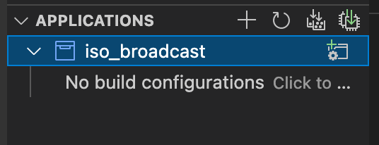

  • Hi Marte,
    I get the west error when I try to build a new build configuration. At the moment, I don't have any old build configurations to delete:
    Clicking on the "+" sign to create a new build configuration gives me the west error.
    I have also done a clean install of the nRF SDK (via Toolchain Manager) and completely cleaned an re-installed VS Code several times but I still get the error.
    AC
  • Hi Marte,
    Just to let you know, I completely removed all nRF Connect SDK versions (and a Zephyr library that I had in another unrelated folder). Then I cleaned VS Code by removing the ~/.vscode file and ~/Library/Application Support/Code folder. I then re-installed three versions of nRF Connect SDK: 1.8.0, 1.9.0 and 1.9.1.
    Joyful, joyful, I can now create build configurations for nrf5340dk_nrf5340_cpuapp and nrf5340dk_nrf5340_cpunet for all three SDK versions.
    I don't know what the original problem was but I suspect that some configuration in the SDK was corrupted/set incorrectly. Deleting the SDKs and re-installing cleaned things up.
    Let's close this thread and thank you for your support.
