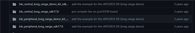

I am using Segger Embedded Studio and nRF5_SDK_v15.0.0 .Available kits for testing are nrf52833DK and rak4630(nrf52840).
We want to test nRF52833 support on long-range. I referred to https://github.com/NordicPlayground/nRF52-ble-long-range-demo. In this link, code is available for the nrf52840. I tried to migrate the code for the scanner from nrf52840 to nrf52833. I tried to migrate it, but it generated errors like missing  pca10100.h / nrf52833.h and other files. I added all the missing files but still the error. Although migration from 52840 to 52833 is simple, we just have to change a few parameters in the .emproject file and it worked for me with other examples but not with this. Before that, I tried this link   https://devzone.nordicsemi.com/f/nordic-q-a/65136/migration-from-nrf52840-to-nrf52833  to migrate the code for other examples it worked perfectly for me.
I faced the following issues the first time while migrating the code.
nrf52833.h header files and the other two files were missing as shown in the image below. I added the files after that more errors occurred to show the missing files I added almost 10 files but still no success.
Is there any easy /alternate method to migrate the code for this type of situation?
    SDK 15.0.0 did not have support for the nRF52833 IC, so porting the project would require some additional patching of the SDK as well as setting up the project. It would be better to start with the latest nRF5 SDK (v17.1.0 at time of writing) and either port the long range sample to it, or make a new one based on existing sdk examples. The 'pca10100' configurations you will find in this SDK are configured for the 52833 ic.

  • Hi
    You can find the example at my github which I did before.
    https://github.com/jimmywong2003/nrf52-ble-range-estimator
    It has the nRF52840 and nRF52833 example.
