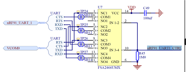

We are running the Serial LTE Modem sample on the nrf9160 DK. We are currently communicating AT commands via the USB cable and VCOM2.
However we would like to route these uart lines to the external pins, so that we can communicate with it from a different CPU. Our understanding is that we need to program P1.12 on the nrf52 to "0"? Is this indeed the case? How does one go about doing this? A switch would be a lot easier...
What firmware is by default running on the nrf52, if any, so that we can edit the correct firmware and not overwrite anything incorrectly.

  • Hi Sigurd,
    Sorry for the late response, other items had higher priority and I can focus on this part now.
    For the nRF52 on the nRF9160DK, see This case.
    Can you please advise how we get this source code into a project? We are having real frustating experiences with the nordic tools and Segger Embedded Studio.  Anyways, we simply only want to change the state of the nrf91_UART1_CTRL pin so that the UART signals are not routed to VCOM0:
    This only requires setting the state of a GPIO pin according to me? No board overlay files should be needed? We simply just want the get the source code provided in this case into a SES project so that we can change the state of the pin and program the nrf52 correctly as to not break the behavior of the entire devkit.
    Can you please provide us with such a project setup or at least just how we can add it to a project.
  • Hi
    To clarify:
    The figure you post are of UART1.
    The original post is asking for UART2.
    Is it important for you which UART is routed to the external pins?
