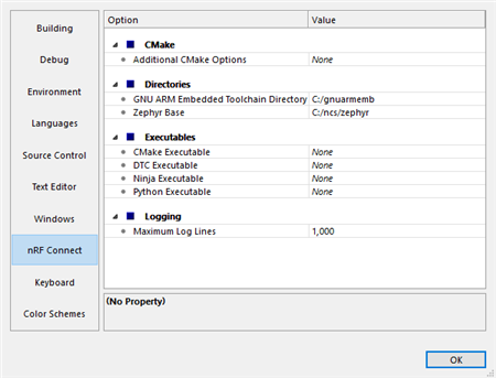

  • after all setup i am getting this error, can you suggest how to solve it ?
    When you get this error pop-up you also get a more detailed description of the error or errors in the output terminal. Make sure you have selected to show 'Transcript' and 'Output', then copy the complete text output and upload it here.
    Marte
  • Below is error log
    Creating solution blinky.emProject
    cmake -GNinja -DBOARD=nrf52dk_nrf52832 -DBOARD_DIR=C:\Users\Ecloud10\ncs\v1.9.1\zephyr\boards\arm\nrf52dk_nrf52832 -BC:\Users\Ecloud10\ncs\v1.9.1\zephyr\samples\basic\blinky\build_nrf52dk_nrf52832 -SC:\Users\Ecloud10\ncs\v1.9.1\zephyr\samples\basic\blinky -DZEPHYR_TOOLCHAIN_VARIANT=gnuarmemb -DGNUARMEMB_TOOLCHAIN_PATH=C:\gnuarmemb -DEXTRA_KCONFIG_TARGETS=menuconfig_ses -DEXTRA_KCONFIG_TARGET_COMMAND_FOR_menuconfig_ses=C:\Nordic Semiconductor\arm_segger_embedded_studio_v568_win_x64_nordic/html/configure_nordic_project_menuconfig.py

    CMake Error at C:/Users/Ecloud10/ncs/v1.9.1/zephyr/cmake/compiler/gcc/generic.cmake:9 (message):
    Zephyr was unable to find the toolchain. Is the environment misconfigured?
    User-configuration:
    ZEPHYR_TOOLCHAIN_VARIANT: gnuarmemb
    Internal variables:
    CROSS_COMPILE: C:/gnuarmemb/bin/arm-none-eabi-
    TOOLCHAIN_HOME: C:/gnuarmemb
    C:/Users/Ecloud10/ncs/v1.9.1/zephyr/cmake/generic_toolchain.cmake:42 (include)
    C:/Users/Ecloud10/ncs/v1.9.1/zephyr/cmake/app/boilerplate.cmake:542 (include)
    C:/Users/Ecloud10/ncs/v1.9.1/zephyr/share/zephyr-package/cmake/ZephyrConfig.cmake:24 (include)
    C:/Users/Ecloud10/ncs/v1.9.1/zephyr/share/zephyr-package/cmake/ZephyrConfig.cmake:40 (include_boilerplate)
    CMakeLists.txt:4 (find_package)
    error: cmake failed
    create_nordic_project.py failed (1)
    Is there a specific reason for why you are selecting NONE/PATH as toolchain version when opening the project in SES even though you have installed the SDK using Toolchain Manager? If not, I would suggest selecting the toolchain installed with Toolchain Manager, i.e. select 1.9.1 here:
    If you are still seeing an issue when selecting this, please try the fixes in Common fixes for nRF Connect SDK build problems and see if any of them fixes the issue.
