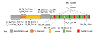

  • I see, I will try to summarize the timing scheme within the IO-Link Wireless protocol as much as I can.
    Down below a picture of a sub-cycle between master and slave is shown. This is a scheme that show a complete communication exchange between master and slave.
    As you can see the yellow part is the downlink (master to slave), and the green parts are the uplinks (slave to master). So a downlink is sent from the master and received by all slaves, and then, the uplinks are returned in a special order to the master.
    At the end of each uplink and downlink the IO-Link Wireless protocol requires a 4 byte CRC. Note that between each green slot, there is a red interval to avoid collision on air (guard interval). This guard interval is 8 us, which means that the master (considering this software solution) needs to be able to calculate a 4 byte CRC within LESS than 8 us
    So, we are very interested in knowing if the CPU is able to do this. Can it calculate a 4 byte CRC this fast? Is there a way to measure the processors execution time? I looked online and it seems to be a bit more complicated that I thought. Please let me know if this information that I have just provided is not sufficient for you to be able to determine weather or not this is possible.

  • Is there a CRC after each of the green sections (before the red sections)? Or is it a CRC after the entire thing in the picture? And is the CRC dependent on the downlink, or can you generate it before the downlink?
    I did not forget to answer this, but I don't know how long it takes. You would need to test this. I guess it depends on what else the nRF is doing at the time, and even if it is doing this as the highest priority I don't know how long this function call will take. It probably depends on the length of what you need to generate the CRC of. Before you ask, I don't know how large a packet you could generate a 4byte CRC below 8µs is either. You need to test.

  • Yes there is a CRC after each of the green sections, Yes, the total length of the downlink is 52 bytes. Which means the CRC will be calculated on the 43 bytes of the downlink since preamble and syncword  does not count (5 bytes) and  i assume that you dont count CRC on CRC. So 52-9 = 43
    Here you can see a picture of an uplink (the green slots in the picture above) and after that a D_GUARD which is 8 us
