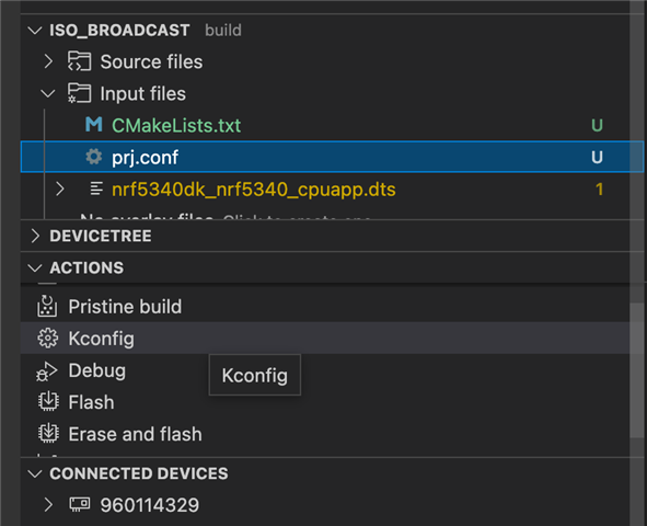

I'm using VS Code to develop an application based on the Zephyr iso_broadcast sample.
How do you edit prj.conf? If I select prj.conf in the Explorer pane, then click on 'KConfig' I get the following error:
If I edit prj.conf directly in VS Code or in a terminal editor, I get a slew of errors of which the key error is (I think) a west manifest version error. Here are the errors:
-- Found west (found suitable version "0.11.0", minimum required is "0.7.1")
CMake Error at /opt/nordic/ncs/v1.9.1/zephyr/cmake/zephyr_module.cmake:61 (message):
    File "/Users/skajam66/.pyenv/versions/3.9.1/lib/python3.9/site-packages/west/manifest.py", line 1284, in __init__
      validate(source_data)
    File "/Users/skajam66/.pyenv/versions/3.9.1/lib/python3.9/site-packages/west/manifest.py", line 468, in validate
      raise ManifestVersionError(min_version_str)
  west.manifest.ManifestVersionError: ('0.12', None)
  The above exception was the direct cause of the following exception:
    File "/opt/nordic/ncs/v1.9.1/zephyr/scripts/zephyr_module.py", line 542, in <module>
      main()
    File "/opt/nordic/ncs/v1.9.1/zephyr/scripts/zephyr_module.py", line 492, in main
      west_proj = west_projects()
    File "/opt/nordic/ncs/v1.9.1/zephyr/scripts/zephyr_module.py", line 375, in west_projects
      manifest = Manifest.from_file()
    File "/Users/skajam66/.pyenv/versions/3.9.1/lib/python3.9/site-packages/west/manifest.py", line 1141, in from_file
      return Manifest(**kwargs)
    File "/Users/skajam66/.pyenv/versions/3.9.1/lib/python3.9/site-packages/west/manifest.py", line 1286, in __init__
      raise ManifestVersionError(mv.version, file=source_file) from mv
  PosixPath('/opt/nordic/ncs/v1.9.1/nrf/west.yml'))
  /opt/nordic/ncs/v1.9.1/zephyr/cmake/app/boilerplate.cmake:175 (include)
  /opt/nordic/ncs/v1.9.1/zephyr/share/zephyr-package/cmake/ZephyrConfig.cmake:24 (include)
  /opt/nordic/ncs/v1.9.1/zephyr/share/zephyr-package/cmake/ZephyrConfig.cmake:35 (include_boilerplate)
  /Users/skajam66/ECSL/iso_broadcast/iso_broadcast/build/CMakeLists.txt:5 (find_package)
CMake Error at /opt/nordic/ncs/v1.9.1/nrf/cmake/multi_image.cmake:409 (message):
  CMake generation for hci_rpmsg failed, aborting.  Command: 1
  /opt/nordic/ncs/v1.9.1/nrf/cmake/multi_image.cmake:150 (add_child_image_from_source)
  /opt/nordic/ncs/v1.9.1/nrf/samples/CMakeLists.txt:142 (add_child_image)
See also "/Users/skajam66/ECSL/iso_broadcast/iso_broadcast/build/CMakeFiles/CMakeOutput.log".
See also "/Users/skajam66/ECSL/iso_broadcast/iso_broadcast/build/CMakeFiles/CMakeError.log".
FATAL ERROR: command exited with status 1: /opt/nordic/ncs/v1.9.1/toolchain/bin/cmake -DWEST_PYTHON=/opt/nordic/ncs/v1.9.1/toolchain/opt/[email protected]/bin/python3.9 -B/Users/skajam66/ECSL/iso_broadcast/iso_broadcast/build -S/Users/skajam66/ECSL/iso_broadcast/iso_broadcast -GNinja -DBOARD=nrf5340dk_nrf5340_cpuapp -DCMAKE_EXPORT_COMPILE_COMMANDS:BOOL=On -DNCS_TOOLCHAIN_VERSION:STRING=NONE -DCONFIG_DEBUG_OPTIMIZATIONS:STRING=y -DCONFIG_DEBUG_THREAD_INFO:STRING=y -DCONF_FILE:STRING=/Users/skajam66/ECSL/iso_broadcast/iso_broadcast/prj.conf
