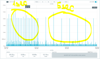

Power Profiler timestamp issue
I am using the beacon mod example with my nRF52-DK to calc battery life. All measurements are taken with PPK2 (a great tool by the way), but in the PC application my timestamp (tested via BLE 100 and 5000 ms should be) does not match at all with what it should be, and instead of 500 seconds log (at maximum resolution) I can measure 3-4 times less. How to fix it?
