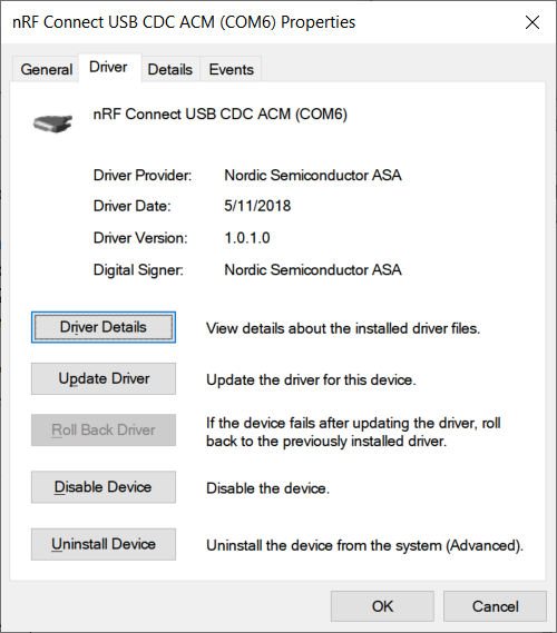

After such upgrade the device appears in the device manager as USB Serial Device (COM8) with VID_1915&PID_521B and with the pretty old driver installed:

After such downgrade the device appears in the device manager as nRF Connect USB CDC ACM (COM6) with VID_1915&PID_C00A and with the new driver installed:

    This seems related to USB only, so the SoftDevice itself should not be relevant, but the SDK could be. Are you also changing SDK version, or only SoftDevice? Which (two) SDK versions are you using? Also, are there any issues or does this still work and you just wonder why Windows picks one driver in one case and another diver in the other case?
  • Hi Einar,
    Thank you for your response!
    I am changing the SDK version. Previously the connectivity application firmware was built using nRF5_SDK_15.3.0 and SoftDevice of v6.1.1 is part of that SDK. Now I am building the connectivity application firmware using nRF5_SDK_17.1.0 where SoftDevice of v7.2.0 is part of.
    It seems the problem is not with just drivers, the device itself is not functioning - sd_rpc_open API which initializes the SoftDevice module fails with error 0x000d NRF_ERROR_TIMEOUT after an upgrade.
