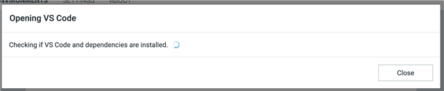

Second - even after installing that, I'm stuck forever in nRF Connect for Desktop on « Checking if VS Code and dependencies are installed »
    Instead of using our Toolchain Manager to download the packs, you could try to install them using VS Code Marketplace first, from the nRF Connect Extension Pack. This might make the process faster next time you install our extension.
