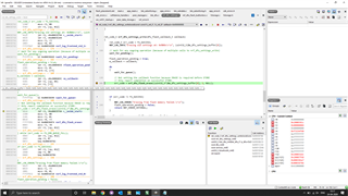

  • Thanks for the quick reply .
    I don't think the pointer is at 0x0003FC00. Attaching the screenshot of the debug trace for your reference.
    Best,
    Krish
  • Yes, looking at the .map file you sent I see that the bootloader settings are place at 0x3ef84
    .bootloaderSettings
                    0x000000000003ef84      0x400
                    0x000000000003ef84                __bootloaderSettings_start__ = .
     *(.bootloaderSettings .bootloaderSettings.*)
     .bootloaderSettings
                    0x000000000003ef84      0x400 Output/SpineFit Strack Internal/Obj/nrf_dfu_settings.o
                    0x000000000003ef84                m_dfu_settings_buffer
                    0x000000000003f384                __bootloaderSettings_end__ = (__bootloaderSettings_start__ + SIZEOF (.bootloaderSettings))
                    0x0000000000000400                __bootloaderSettings_size__ = SIZEOF (.bootloaderSettings)
                    0x000000000003f384                __bootloaderSettings_load_end__ = __bootloaderSettings_end__
                    0x0000000000000001                . = ASSERT (((__bootloaderSettings_start__ == __bootloaderSettings_end__) || ((__bootloaderSettings_end__ - __FLASH_segment_start__) <= __FLASH_segment_size__)), error: .bootloaderSettings is too large to fit in FLASH memory segment)
                    0x000000000003f384                __data_load_start__ = ALIGN (__bootloaderSettings_end__, 0x4)
    The m_dfu_settings_buffer is placed in a section called .bootloaderSettings.
    uint8_t m_dfu_settings_buffer[CODE_PAGE_SIZE] __attribute__ ((section(".bootloaderSettings")))
                                                  __attribute__((used));
    I cant see any bootloaderSettings in your flash_placement.xml file you attached to your question, so need to add this snippet to your projects flash_placement.xml file
    <MemorySegment name="bootloaderSettings" start="0x0003FC00" size="0x400">
        <ProgramSection alignment="4" keep="Yes" load="No" name=".bootloaderSettings" address_symbol="__start_bootloader_settings" end_symbol="__stop_bootloader_settings" start = "0x0003FC00" size="0x400" />
    </MemorySegment>
