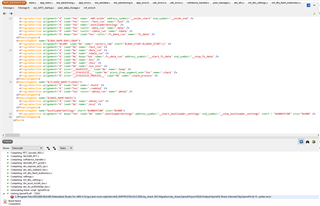

  • Hi Bjorn,
    I have added the recommended lines to the flash placement file and it is giving me the syntax error while linking .elf files.
    Attaching the screenshot for your reference.
    Also attaching the modified flash placement file for your reference.

  • You have two .bootloader sections one in the first memory segment and one in the last. Can you try to remove the
    <ProgramSection alignment="4" load="Yes" name=".bootloaderSettings" />
    in the first memory segment, i.e.
