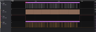

SPIS data corrupted (using example firmwares for SPIS and NRFx_SPIM)
I'm currently trying to set up a simple demo using 2 dev kits running the SPIS and NRFx_SPIM examples but the SPIS seems to always send corrupted data over the MISO line. I've attached zips of my spis and nrfx_spim firmwares below.  The only changes remaining are a slightly updated test string and the disabling of DCX.
0552.nrfx_spim.zip
6523.spis_chars.zip
Rather than sending the expected "nordic123456", the slave device sends out ".ordic123456" where the period is NRF_LOG_HEXDUMP_INFO's attempt at interpreting 'FF' or 'CE'. Am I not supposed to use the spis example firmware with the nrfx_spim? Surely someone must have run into this problem before.
Also at this point I've tried out multiple physical dev kits to make sure there wasn't some hardware/chip specific/lemon issue. Furthermore, I've tried adding delays between the toggling of CS and data being shifted out over MOSI but for whatever reason, no matter how long of a delay I add, the delay doesn't change anything.
Any help would be greatly appreciated. I've been stuck on this for weeks and can't seem to move past it.
Kindest regards,
Ryan

  • Hi Ryan,
    Well,the nrfx_spim example wasn't made to be used together with the SPIS example, but I'm sure that it should work with some modifications. I did some quick tests and was able to get the SPIS to send the correct data by adjusting the buffers size on the SPIS end so that it was equal to the buffers on the master side, disable the DCX, and decreasing the frequency to 250 kHz. I'm not sure exactly why decreasing the frequency helped but it seems like the SPIS isn't able to answer in time with the nrfx_spim running at 1 MHz.
    1MHz:
    250K Hz:
    I suggest that you try the SPI master example and compare the output on the signal pins with the nrfx_spim example and see if you find any difference.
    best regards
    Jared

  • Hi again,
    I saw that my colleague gave you a good suggestion here. Could you try to follow up his suggestion and see if that fix your issue?
    regards
    Jared
  • Jared you caught me - I was worried that thread had died so I posted again.
    Regardless, your suggestion indeed worked! Furthermore, the other thread also bore successful fruit. For anyone else who may run into the same mistake, I ran into: the final solution involves increasing the delay between CS going low and data being shifted over MOSI/MISO. The best way to ensure this seems to be toggling CS in software on your own.
