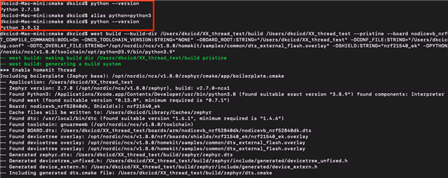

I can't use CLI(command line interface) to build code, but VS Code is workable.
CLI build log:
dkcicd-Mac-mini:v1.8.0 dkcicd$ west build --build-dir /Users/dkcicd/XX_thread_test/build /Users/dkcicd/XX_thread_test --pristine --board nodicevb_nrf52840dk -- -DCMAKE_EXPORT_COMPILE_COMMANDS:BOOL=On -DNCS_TOOLCHAIN_VERSION:STRING="NONE" -DCONF_FILE:STRING="prj_debug.conf" -DBOARD_ROOT:STRING="/Users/dkcicd/XX_thread_test" -D THREAD=y

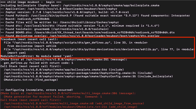

=== child image mcuboot -  begin ===
Including boilerplate (Zephyr base): /opt/nordic/ncs/v1.8.0/zephyr/cmake/app/boilerplate.cmake
-- Application: /opt/nordic/ncs/v1.8.0/bootloader/mcuboot/boot/zephyr
-- Zephyr version: 2.7.0 (/opt/nordic/ncs/v1.8.0/zephyr), build: v2.7.0-ncs1
-- Found Python3: /usr/local/bin/python3.9 (found suitable exact version "3.9.12") found components: Interpreter
-- Board: nodicevb_nrf52840dk
-- Cache files will be written to: /Users/dkcicd/Library/Caches/zephyr
-- Found dtc: /usr/local/bin/dtc (found suitable version "1.6.1", minimum required is "1.4.6")
-- Found toolchain: gnuarmemb (/opt/nordic/ncs/v1.8.0/toolchain)
-- Found BOARD.dts: /Users/dkcicd/XX_thread_test/boards/arm/nodicevb_nrf52840dk/nodicevb_nrf52840dk.dts
-- Found devicetree overlay: /opt/nordic/ncs/v1.8.0/bootloader/mcuboot/boot/zephyr/dts.overlay
  File "/opt/nordic/ncs/v1.8.0/zephyr/scripts/dts/gen_defines.py", line 33, in <module>
    from devicetree import edtlib
  File "/opt/nordic/ncs/v1.8.0/zephyr/scripts/dts/python-devicetree/src/devicetree/edtlib.py", line 77, in <module>
    import yaml
ModuleNotFoundError: No module named 'yaml'
CMake Error at /opt/nordic/ncs/v1.8.0/zephyr/cmake/dts.cmake:251 (message):
  gen_defines.py failed with return code: 1
  /opt/nordic/ncs/v1.8.0/zephyr/cmake/app/boilerplate.cmake:545 (include)
  /opt/nordic/ncs/v1.8.0/zephyr/share/zephyr-package/cmake/ZephyrConfig.cmake:24 (include)
  /opt/nordic/ncs/v1.8.0/zephyr/share/zephyr-package/cmake/ZephyrConfig.cmake:35 (include_boilerplate)
  CMakeLists.txt:44 (find_package)
CMake Error at /opt/nordic/ncs/v1.8.0/nrf/cmake/multi_image.cmake:306 (message):
  CMake generation for mcuboot failed, aborting.  Command: 1
  /opt/nordic/ncs/v1.8.0/nrf/cmake/multi_image.cmake:68 (add_child_image_from_source)
  /opt/nordic/ncs/v1.8.0/nrf/modules/mcuboot/CMakeLists.txt:216 (add_child_image)
See also "/Users/dkcicd/XX_thread_test/build/CMakeFiles/CMakeOutput.log".
See also "/Users/dkcicd/XX_thread_test/build/CMakeFiles/CMakeError.log".
FATAL ERROR: command exited with status 1: /usr/local/bin/cmake -DWEST_PYTHON=/Applications/Xcode.app/Contents/Developer/usr/bin/python3 -B/Users/dkcicd/XX_thread_test/build -S/Users/dkcicd/XX_thread_test -GNinja -DBOARD=nodicevb_nrf52840dk -DCMAKE_EXPORT_COMPILE_COMMANDS:BOOL=On -DNCS_TOOLCHAIN_VERSION:STRING=NONE -DCONF_FILE:STRING=prj_debug.conf -DBOARD_ROOT:STRING=/Users/dkcicd/XX_thread_test -D THREAD=y
VS Code build log :

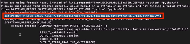

-- Application: /Users/dkcicd/XX_thread_test
-- Found Python3: /opt/nordic/ncs/v1.8.0/toolchain/opt/[email protected]/bin/python3.9 (found suitable exact version "3.9.6") found components: Interpreter

Error message (cut from CLI build log):
    import yaml
I guess maybe python location miss match.
  • VS code python location :
    • /opt/nordic/ncs/v1.8.0/toolchain/opt/[email protected]/bin/python3.9.   <=== build success
  • CLI python location :
    • /Applications/Xcode.app/Contents/Developer/usr/bin/python3.8.  <=== build fail
Because this PC is build server, so I can't directly change python location setting.
I need to know how to correctly setup for CLI build (zephyr), could anyone please give me some advice to fix it? Thanks. Slight smile

  • Yap, previous post that is build server's screenshot.
    So in my build server already had correctly python folder and VS Code can reference it.
    But CLI will reference to system's python not SDK's.
    Could you share me how to let CLI reference to SDK's python folder?
    Prince

  • Hi Edvin,
    I test 'alias', the python version really update.
    But cmake get python location still wrong, so build process still fail...Orz
    Could you have any idea? Slight smile
    It's very strange and hard, appreciate for your great supporting.
    BR,
    Prince

    I have a good news that's I fixing the issue through modifying cmake file to assign SDK's Python while building. I try to record what I did and hope that can help who has the same issue.
    As my build server environment, SDK's Python location is "/opt/nordic/ncs/v1.8.0/toolchain/opt/[email protected]/bin/python3.9"
    step 1. Launch cmake file that response for detecting Python location
    vim $(Nordic_SDK_folder)/zephyr/cmake
    step 2. Assign target Python location in cmake file
    set(PYTHON_PREFER_EXECUTABLE "/opt/nordic/ncs/v1.8.0/toolchain/opt/[email protected]/bin/python3.9")
    Now I can build code through CLI.
    Prince
