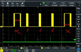

I set and reset an IO PIN in the IRQ to implement a single wire communication. I can't use the GPIOTE because I have to switch between Input and Output Config of this PIN. Now the problem is, that sometimes, the frame is corrupt when something in parallel is working on the nRF (GPIOTE, BLE Mesh, ...)
I like to delete this frame by checking the complete time of this bit frame. Reading out the timer value (Timer1) after the last Bit doesn't fix the problem, I have the same timer value even in a frame which is too long. Maybe I need to check it with Systick or what do you suggest?
Here is the Picture with the frames with timegaps:
The green CH2 is the 10ms tick which start this timer

Dominik Eugster said:I set and reset an IO PIN in the IRQ to implement a single wire communication. I can't use the GPIOTE because I have to switch between Input and Output Config of this PIN. Now the problem is, that sometimes, the frame is corrupt when something in parallel is working on the nRF (GPIOTE, BLE Mesh, ...)
In general you may never guarantee that a GPIO toggle by the CPU directly will happen at a specific time in a task-event system, since the CPU may be busy processing a higher priority interrupt (such as an BLE radio event). The only way to ensure this is thus to cut the necessary CPU intervention out of the loop, such as when using PPI to have a peripheral event trigger another peripherals task.
Dominik Eugster said:I like to delete this frame by checking the complete time of this bit frame. Reading out the timer value (Timer1) after the last Bit doesn't fix the problem, I have the same timer value even in a frame which is too long. Maybe I need to check it with Systick or what do you suggest?
I am not sure I understand what you mean when you say that you are getting the same value for frames of different length. What frequency is the TIMER instance you are using configured to?

Thanks for the Input. I can't use the GPIOTE becazse I have to switch between Input and Output (single wire communication to a chip)
But it works now, If I pasue and resume the timer, because the timer is really fast (20us tick), timer is runs at 16MHz and a capture compare value lower than approx. 240 (timer value) can't be handled because of the switch from input and output and setting the GPIO levels, the irq routine needs to much time and it can't be shorter because of the single wire communication to the chip... But I manged that I set CC2 value to 120% of the expected frame time and when this CC2 event occurs, I know that a radio event or some other higher priorized IRQ blocked this routine.
The timer works correctly, but sometimes the IRQ CC1 event isn't triggered because of a BLE radio interrupt. With CC2 I can detect this "problem" and ignore this currupt frame.
