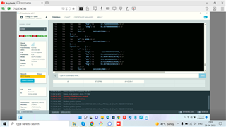

hello sir ,
 i am using thigy91 board and uploaded the asset tracker application code from  ncs sample code . ii am getting humidity data on my azure cloud .but there was no data available regarding motion sensor.
1. Is there any way for test motion sensor data ,any AT command for it for LTE monitor.
2. Is I need to solder SB6 and SB5 pin to get data.
