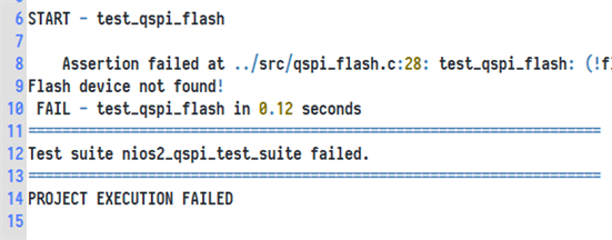

log:flash devece not found!

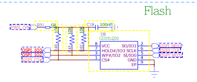

    thanks for reply, wo read your link.
    i can runing with mx25r64 flash on DK,it's work well.
    but change to GD25LQ32EEIGR,log:flash devece not found!

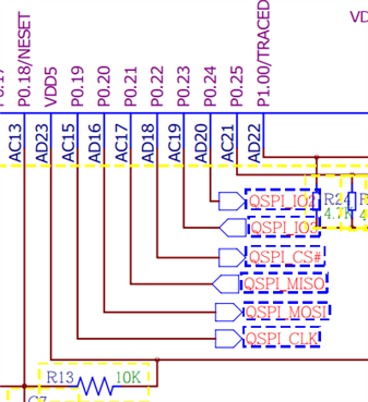

  • Hello,Kenneth,
    thanks for your reply.
    i' have change the pin in overlay file.

    &qspi {
    	status = "okay";
    	sck-pin = < 0x13 >;
    	io-pins = < 0x15 >, < 0x14 >, < 0x18 >, < 0x17 >;// MISO=IO0  MOSI=IO1  IO2  IO3
    	csn-pins = < 0x16 >;

    the pin PWR_1V8  voltage is 1.8V.(Measure with a multimeter)
    Best Regards
  • The code I supplied should run as-is on the nRF52840-DK with no changes, does it work then?
    Are you trying to interface your flash device from the nRF52840-DK in this case? I can see the supply voltage is different, so I don't know how this would work.
    Kenneth
