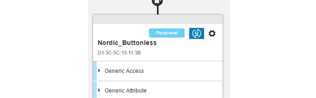

Is there any tutorials or examples avaialble for adding DFU service? I would like to add DFU service for my application. I am using nRF52840 development board with S140 softdevice.

    Is this usual error? I meant when I add with bootloader does it solve?
    When I added bootloader this problem solved. also I required to update the sdk_config.h in nrf_bootloader with the following
    #ifndef NRF_DFU_BLE_REQUIRES_BONDS
    #define NRF_DFU_BLE_REQUIRES_BONDS 1
    while my dfu required bonding...
    Now it is compiled successfully without any error but I am not getting the DFU symbol on my nrf connect desktop. How can it happen? I followed the exact steps which you have suggested.
    (DfU) icon not showing...
