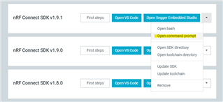

  • Hi David,
    You could do a reverse lookup of the PC(Program Counter) and LR(Link Register). This should tell you where in the code the error comes from. Here is one way to look up:
    1. For example open Toolchain Manager and open command prompt:
    2. Navigate to your project folder.
    3. Run this command:
      arm-none-eabi-addr2line -e build/zephyr/zephyr.elf 0xFAULTING_ADDRESS
      where you replace 0xFAULTING_ADDRESS with 0x353a2.
    4. Run the same command again using LR = 0x000292e9.
    Please let us know how it goes.
    Håkon
