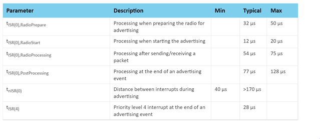

From the table taken from the documentation on BLE radio blocking time during advertisement shown below, it seems the maximum blocking time is 128us.
My first question is this, at 256Hz would this affect the sampling rate enough to warrant using PPI method to trigger ADC instead?

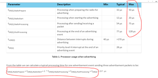

    The maximum blocking time for one advertising event would be the marked formula with the max parameters:
    If you want a window where it can guarantee that you wont be interrupted then I would suggest using Radio Timeslots.
