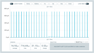

Now I'm dealing with some strange behaviour I see in the current consumption while in power off in the power profiler (PPK-II). Current is not flat and peaks at an approximately constant pace.
Before going to power off, I disable the console's uart with a call to pm_device_action_run(cons, PM_DEVICE_ACTION_SUSPEND), where cons is const struct device *cons = device_get_binding(DT_LABEL(DT_CHOSEN(zephyr_console))).
Is there any reason to expect such behaviour?

Can you upload the .ppk file here by exporting it from the Power Profiler app and uploading it in a .zip file so we can get a better look at what's going on here. We'll need to zoom in more on these spikes to determine what they are exactly.

Simonr, please find here the data captured and the project for reproducing the behaviour.
It was not possible for me to compile neither the original project nor a new project created using the sample as a template. This project uses snippets from the original code.
