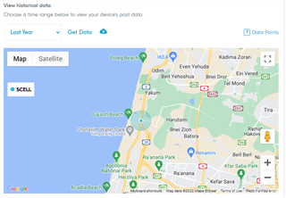

Problem connecting LTE with SLM app using IBASIS eSIM
I have 2 boards, one with monogoto esim and one with ibasis esim when I try with monogoto everything is working fine

when I try with ibasis esim i can't get registered

I even tried to define the APN but still nothing.
I checked all available errors
#38: network failure
#19 "ESM failure"
#17 – Network failure
#15 – No suitable cells in tracking area
so it seems maybe related to sim provider or coverage, BUT, when I program asset tracker the ibasis sim was connected and worked
was connected to cloud
sim is registered and working
Any suggestions what I might be missing?
