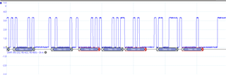

 I am using an STM32L4 chip that sends an update to the nRF52832 on a ublox module over USART. I assume the nordic chip is in the bootloader during the update.
We get a UART error: 4 and when we observe the UART lines we see that on the TX line of the nRF the stop bit is not present. I assume the nRF does not pull the line high properly after transmitting a frame. (we do not use pull-up resistors on the USART lines on STM32L4 side)
When trying to update with an OTA the device updates but then falls back into the bootloader at startup making me assume the problem is with the bootloader.
I am wondering if there is such documented cases of bootloader errors or if the missing stop bit could point to another issue with my HW/SW?
Thank you for any hint!
Bad behavior with missing stop bit:
Good behavior with stop bit present:

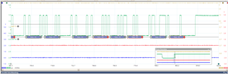

Bad behavior with
  • blue: CTS
  • red: RTS
  • green: UART RX
  • yellow: UART TX
  • We get a UART error: 4 and when we observe the UART lines we see that on the TX line of the nRF the stop bit is not present. I assume the nRF does not pull the line high properly after transmitting a frame. (we do not use pull-up resistors on the USART lines on STM32L4 side)
    This UART error:4, is it on the nRF end or the STM end? UART on nrf52832 is quite mature peripheral and I do not suspect that there is an hardware issue with it.

    --> What I also noticed is that in the above measurements of UART the Stop bit is present, just not long enough. What might cause this? Maybe the unconventional UART frequency?
    --> The reason for the Hardware being suspicious is that the error only occurs sometimes and only on some devices
    Can you try this with lower frequencies and sees if the behavior is the same. I have not heard of inadequate length of stop bit before.I am also not able to see any internal pull configuration on the pins if there are any. Have you setup pullup on the com pins from the SoC?
  • I will try with lower frequency values and enabling the pullup on RX and TX lines on STM32-side.
    I also found that the error only occurs at higher temperatures for which there are similar issues already:
    https://devzone.nordicsemi.com/f/nordic-q-a/22876/uart-heat-problem
    https://devzone.nordicsemi.com/f/nordic-q-a/52065/uart-frame-errors
    They propose to turn on the HFCLK for UART transmission with sd_clock_hfclk_request()
