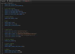

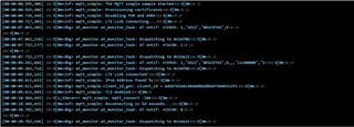

I come from China and am using your company's NRF9160DK product now. I burned asset_cracker_v2 a long time ago. There is no problem connecting NRF_CLOUD, but when I burned DEMO MQTT Simple, I found that I could hardly connect the broker. I have also configured NBIOT network in the PRJ file, and I have tried to change the server for many times, but it can hardly be realized on the board. It has bothered me for several days, please help me.

  • Ok. The log file shows you enable TLS, have you done any test without enabling TLS?

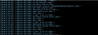

  • Thanks. After taking your suggestion, I disabled TLS (I always thought it was a necessary option, which led to my suspicion that there was a local network problem), and now I can communicate with you. Then I added username and password of our server, which is also ok, but now there isa problem. It seems that there is something wrong with the MQTT echo, I can receive the data sent by pressing button in MQTT.FX, but the monitor does not show the data I sent from MQTT.FX, I have no idea. Please give me your help

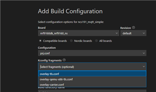

    1) I wonder why you enable TLS on your application on purpose in the begining? because it is one optional choice so your building will not include this overlay-tls..conf  TLS configuraiton by default.
    2) The log you shared shows noting about which topic you subscribe to, so this might be one issue related to how you build the sample.
    I strongly suggest you use NCS fo VS code to build nRF9160: Simple MQTT — nRF Connect SDK 1.9.1 documentation (nordicsemi.com) with default setting and show me the log from LTE Link Monitor->Open LOG FILE.
