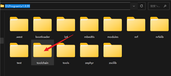

    i've copy toolchain folder from v1.9.1.
    and config

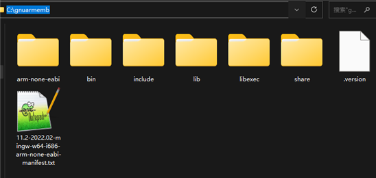

    and now i've manually install.
    >set GNUARMEMB_TOOLCHAIN_PATH=C:\gnuarmemb\
    i don't know,why VSCode still need  find tool in v1.9.1 folder.
    Best regards

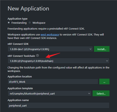

    why toolchains still point 1.9.1 folder? where to change it?
    thanks
    Best regards
  • Please provide the output as a text file and not as screenshot.
    I am very confused. Are you trying to do git pull to the v1.9.99-dev1 folder that you initialized with west init? You are supposed to update within v1.9.1 folder if installed using Toolchain Manager.
    If not, please manually install the nRF Connect SDK following manual steps.
