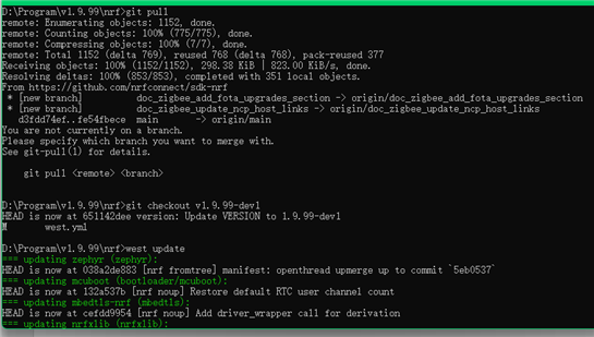

VSCode update NCS
VSCode,  i change NCS1.9.1 to v1.9.99,
restart computer,but got error:
OUTPUT can not use compilerPath“D:\Program\v1.9.1\toolchain\opt\bin\arm-none-eabi-gcc.exe”
TERMINAL CMake Error: Generator: execution of make failed. Make command was: D:/Program/v1.9.1/toolchain/opt/bin/ninja.exe &&

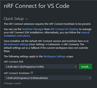

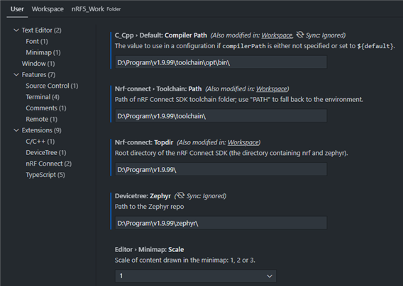

    in fact,i've set it.
    Can't find the real reason.
    Best regards

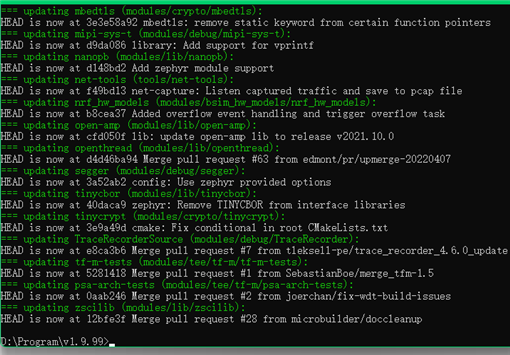

    Øyvind said:
    In the command prompt navigate to the nrf folder and run the following:
    As per my last comment, please navigate to your nrf folder.

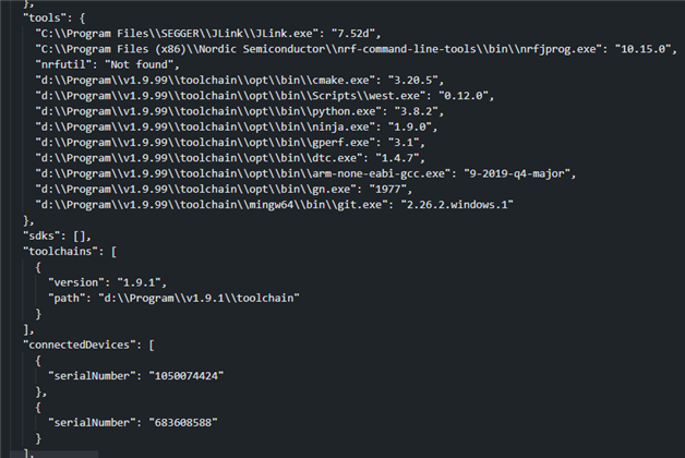

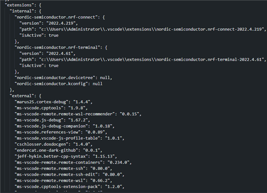

    Generate Support Information:
    why toolchains still point 1.9.1 folder? where to change it?
    thanks
    Best regards
  • Please provide the output as a text file and not as screenshot.
    I am very confused. Are you trying to do git pull to the v1.9.99-dev1 folder that you initialized with west init? You are supposed to update within v1.9.1 folder if installed using Toolchain Manager.
    If not, please manually install the nRF Connect SDK following manual steps.
    Generate Support Information: text

      "extensions": {
        "internal": {
            "version": "2022.4.219",
            "path": "c:\\Users\\Administrator\\.vscode\\extensions\\nordic-semiconductor.nrf-connect-2022.4.219",
            "isActive": true
            "version": "2022.4.61",
            "path": "c:\\Users\\Administrator\\.vscode\\extensions\\nordic-semiconductor.nrf-terminal-2022.4.61",
            "isActive": true
          "nordic-semiconductor.devicetree": null,
          "nordic-semiconductor.kconfig": null
