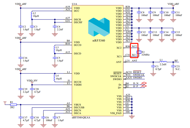

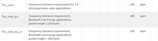

What is the accuracy of the internal capacitance of nRF5340?
The datasheet and devzone didn't find the answer.
