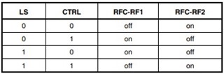

SPDT RF switch is this pe42423 for use with nrf52833
Hi!
Continue the previous case
I try to run zephyr direction finding rx example  direction_finding_connectionless_rx
It seems to me that the external antenna is working fine
This image from PE42423 datasheet
but I can only receive from one antenna.  I refer to this case
I can't understand what configuration I need to change changed
Besides main.c>>""ant_patterns[] = { 0x2, 0x5};""    What document configuration do I need to change?
Please let me know if there is anything need to be revised
Thank!!!
