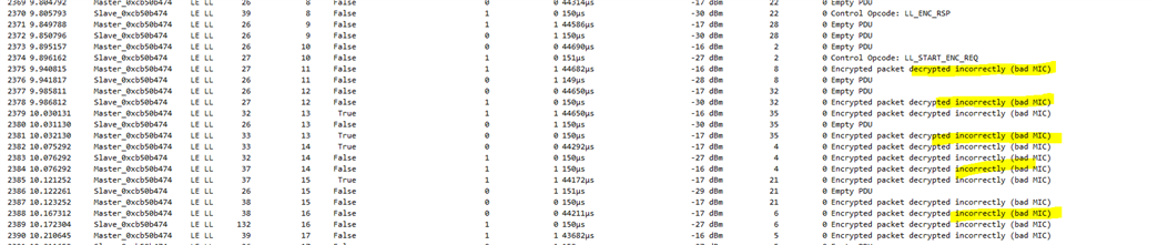

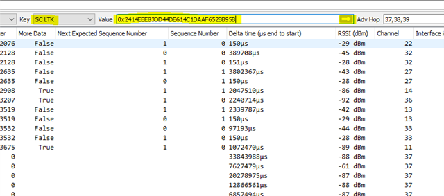

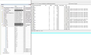

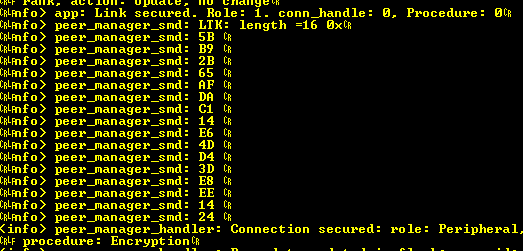

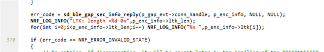

  • Hi Hung,
    I've tried many times, and no good results.
    Look at the attached screenshot: it shows debug values (LTK is seen) and Wireshark tool (LTK is introduced).
    I have proceeded in the way you have told me:
    - Device already bonded to my smartphone
    - I disconnect device from smartphone
    - I set Wireshark to save trace, introduce LTK and push the right arrow
    - I connect device to smartphone
    But not expected results are seen: "bad MIC" is also shown. I have also tried with LTK upside down, but same result...
    Maybe we can talk and meet using remote connection with my computer? Any other idea?
    Dani

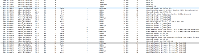

  • Hi Daniel,
    I tested again here and facing the same problem as you. I couldn't decrypt the connection even with the LTK. It's really strange that just a few days ago it worked for me.
    I'm checking with the team if I'm missing something.
    In the mean time I would suggest to try testing with the nRF Connect app on the phone, make sure it's only re-bonding happens and no other activity just to check if the disconnection still happen.
    Also please try to print out in the log any BLE event when you connect.
    Do you store any information in flash ? If you do I would suggest to skip them, just in case they cause issue with the bond information.
    One approach to debug is to step by step removing the functionalities of the application. Until it's get very similar to one of our example in the SDK.  I assume that when you test with the example in the SDK with LESC you didn't have the issue ? Have you tried with the ble_app_gls example ?
