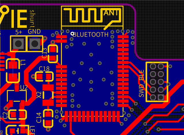

Hi there,
we are a student project and are using the nRF51822 Chip with the MDBT40 module. We designed our own custom PCB and followed the instructions for the circuit as well as the antenna. We already manufactured the PCB. Unfortunately something is wrong with it. When we connect our PCB via USB to the power supply, our voltage regulator gets very hot and somewhere a short develops. Our PCB functions perfectly if we don't solder the MDBT40 module so therefore we assume that the problem lies with the module or the modules circuit and not the rest of our PCB. We also solderd some cables to all used pins of the MDBT40 and connected them to our normal UART, VCC, GND debug pins of the board and everything worked fine. We tried to solve this problem with mulitple PCBs so we don't think the problem accurs due to a soldering short.
Can someone help us? Becuase we have no idea anymore what could cause this problem.
