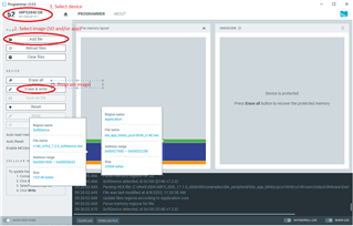

    See the following procedure.
    1. Open nRF Connect for Desktop and launch nRF Connect Programmer.
    2. Connect a development kit to the computer with a micro-USB cable, and turn it on.
      In the navigation bar, No devices available changes to Select device.
    3. Click Select device and select the device from the drop-down list.
      The button text changes to the SEGGER ID of the selected device, and the Device Memory Layout section indicates that the device is connected.
    4. If you have not selected the Auto read memory option under the Device menu and wish to visually see the memory layout before you program, click Read in the menu. If you have selected it, the memory layout will update automatically.
    5. Drag and drop the HEX file into the File Memory Layout section. Alternatively, click Add HEX file on the right pane (named as File) to add the files you want to program, by using one of the following options:
      • Select the files you used recently.
      • If there are no recently used files, click Browse from the drop-down list.
    6. Select the firmware image file (with the extension .hex) from the file browser that opens up.
    7. Click Erase & write in the Device pane to program the device.
    -Amanda

    You use the image from Blinky Example which is the same as the factory image, so the memory layout is the same.
    The images used in my example figure are the s140_nrf52_7.2.0_softdevice.hex from nRF5_SDK_17.1.0\components\softdevice\s140\hex and ble_app_blinky_pca10056_s140.hex generated from nRF5_SDK_17.1.0_ddde560\examples\ble_peripheral\ble_app_blinky\pca10056.
    -Amanda
    -Amanda
