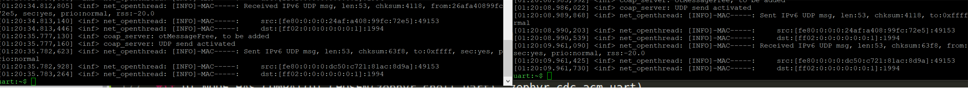

  • I got an update. I think UDP packet is received by the net_openthead but it's not propogated to the callback passed in by otUdpOpen() function. ( I have not verified by nrf sniffer yet)
    There are two devices in this screenshot. both devices are flashed with the code posted above.
    left device addr- fe80:0:0:0:dc50:c721:81ac:8d9a:49153 send to ff02::1:1994 ----> received at right device
    right device addr: fe80:0:0:0:24af:a408:99fc:72e5:49153 send to ff02::1:1994 -----> received at left device
    Do I need to set any type of filter so, it can be seen in callback?
    After adding CONFIG_OPENTHREAD_LOG_LEVEL_INFO=y, I saw the prints starting [INFO]-MAC-----:
