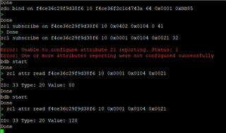

    I tried reading the battery value from read_attr command and I can read it correctly but unfortunately I still cannot subscribe to it. I think I am very close to the solution if you can get some ZIgBee engineer to look at it it would be great. For migration to another SDK is not possible for now.
    If you see the below screenshot(1st line) I can bind my power config cluster(0x0001) but cannot subscribe to it. I can subscribe to 0x0402 cluster though. Then if you see 3rd last line zcl attr read f4ce36c29f9d38f6 10 0x0001 0x0104 0x0021. With this command I can read attribute value and it is giving me correct value. The only problem is I cannot subscribe to this cluster and get it to reporting.

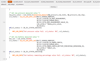

    Here is my code where I am setting the value of battery may be this can help. May be because it is hard coded value of battery and that why its not reporting? Because temperature and pressure sensor values are changing using sensorsim function but my battery value is fixed(for now). But if this is the case at least I should be able to subscribe to it.

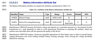

    As far as we saw from the Zigbee ZCL spec and your screenshots everything looks correct with the exception that the configure reporting command fails. The power configuration cluster battery information attribute set should be reportable/subscribable, and what you're doing looks to be correct regarding to formatting. The cluster identifier is 0x0001, the battery percentage remaining is 0x0021, and the type of 0x0021 is uint8 (i.e 32 in decimal).
