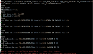

  • HI Andreas,
    Thanks for pointing me to this case. Actually by following that case I already tried to add power config cluster and unfortunately I am stuck at exactly same point where the guy Krystof Vydra is stuck.
    I added power config cluster to multi sensor application. I can see cluster added and can also get reporting from temperature and power sensor but not from power config cluster.
    As you can see in below screenshot power cluster 0x0001 is present in in-cluster list but I cant read value from it.
