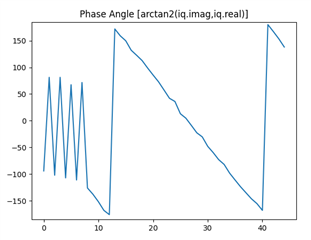

I've successfully built the 'direction_finding_connectionless_tx' project and flashed that to an nRF52833dk, and built the 'direction_finding_connectionless_rx' project with some changes and flashed that to another nRF52833dk connected to a Nordic PCA20054 12-patch antenna array board. I wasn't able to get an official PCA20054, so I built my own from the design files, which makes me suspicious of the data and wanting to do some basic validation before getting too complicated.
As a basic sanity check, if I limit the receiver to only scan on a single antenna, within a single CTE scan all the samples should have very similar IQ values if the transmitter and receiver are stationary right? I know that normally IQ values would change as the signal is modulated, but I thought that's part of what makes the CTE special since it is completely unmodulated giving a constant signal so the differences between different antennas could be compared.

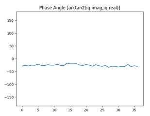

Plotting the phase angle over time from the IQ samples taken from a single antenna gives me the following graph:
Amplitudes appear to remain relatively constant, but the phase angle is constantly falling and I'm not sure why. It appears to be falling at a relatively constant rate which feels like it might be a good thing, but if so I'm missing something.
Thanks for any insight!
  • So I think I figured at least this first hurdle out over the weekend, and what I was missing is that while the CTE signal is "unmodulated" it is mixed with a sine wave and part of the reason for the reference period is to calculate the phase velocity of that mixed signal so it can be subtracted from the rest of the sample to make them all appear incident on all antennas at the same moment.
    Also, for anyone else who finds this, you will want to use the arctan2 function not just the basic arctan.
    The reference period samples are all 180 degrees out of phase with one another which I still don't completely understand, but assuming that and subtracting the phase shift from the samples gives this:
