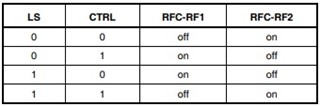

Hello! I use EK42423-03 and 52833-DK
Previous case
I understand plugging in the SWF connector, Will disconnecting from the PCB antenna and routing the signal to the cable.
EK42423-03-Datasheet
LS ->GND CTRL -> P0.26 ; GND -> GNDVDD -> VDDJ1 RFC -> J1 ANT
First follow this pic.
I added code in nrf52833dk_nrf52833.dts
    ant1: ant_1 {
			gpios = <&gpio0 26 GPIO_ACTIVE_LOW>; /*CTRL*/
			label = "ANT 1";
Using multimeter can measure from RF2 to Refer to the pic.
RF1 = 0Ω
RF2 = 20Ω
But why? EK42423-03 "J1"  insert 52833-DK "J1" After Refer to the pic.
RF1 = 0Ω
RF2 = 0Ω
I do not know what is causing.
Sorry, it's been two months and I still can't do it...
But I still hope you can give me advice!
Thanks again for your support.
