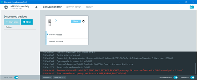

  • sorry, I just tried it again and I still have the same problems.
    - I'm using nRF Connect for Desktop 3.11.1 and installed all pending updates
    - I started the BLE tool, bluetooth low energy, v3.0.1
    - then I inserted my 52840 dongle into USB, ok, its reported as "nRF52 Connectivity" with Mac/ID F10A03B824B0
    - I select this device and hit "start scan" and everything works
    - now I stop this tool and plug in my Texas-Instruments MSP -FET Flash Emulation Tool into USB
    - start again nRF Connect BLE
    - and now I see both, the 52840 dongle and the Texas MSP Tools Driver, like this
    when I now select the dongle, like above, I see these errors in the log window and I'm not able to use the dongle anymore
    I did not start Texas' Code Composer Studio - its just enough to connect the MSP-FET programmer to USB in order to "confuse" the BLE tool and the same things happens when I'm trying to use the BLE programmer tool.
    While the Texas MSP-FET is plugged to USB, I'm not able to use the nRF Connect tools.
    I already showed this (teamviewer session) to your german technical colleague a few weeks ago, but at this time I was not aware that the trouble seems to be caused by the Texas programme. I can easily repeat this on another Win10 PC and I know about another BLE developer having the same issues.
    Matthias

  • I have been testing with the MSP430 USB-Debug-Interface MSP-FET430UIF and was not able to reproduce the issue. So I am not sure what exactly is causing the issue, if it is to a specific MSP-FET programmer that is causing the "crash" of the Nordic device on the Nordic desktop app.
    Might be that the issue is specific to the version MSP-FET that you are using, currently I have not been able to preproduce, this could also be a specific driver issue or a somewhat strange windows anomaly.
    Can you share what drivers for the TI MSP you have installed and what version the USB device you connect is?
