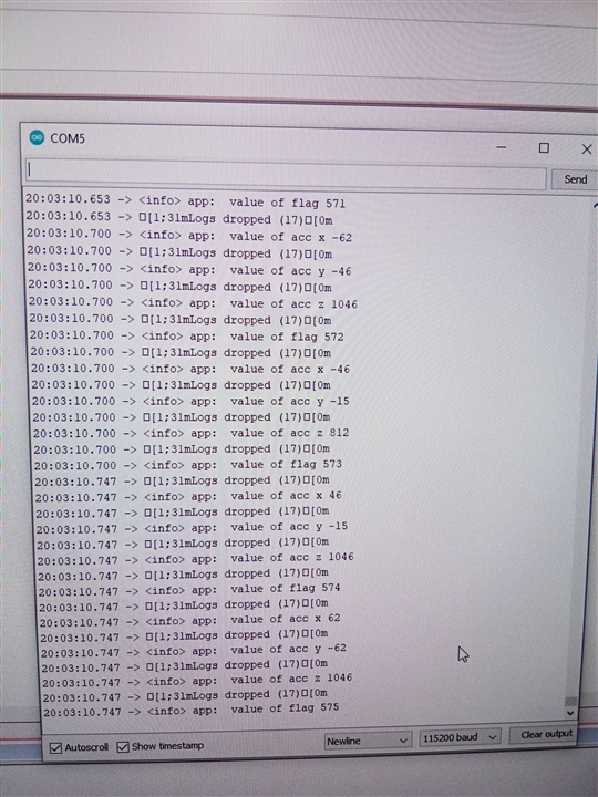

Problem reading LIS3DH FIFO buffer data using nRF52DK I2C
I am using nRF52 DK and LIS3DH accelerometer.
LIS3DH configuration is as follows:
1. LIS3DH ODR set at 10Hz,
2. Low Power Mode (Low resolution),
3. Acceleration: 2g.
4. FIFO mode Enable, and operating in FIFO mode.
I am reading all 32 samples stored in the FIFO buffer using I2C read when OVRN is set.
This cycle is repeated 20 times (total of 32x20=640 samples) with a multishot timer running at 3s intervals. All these samples are stored in an array of size 640. I am not getting the data properly on the serial monitor i.e., sometimes it is saying logs dropped and sometimes data is not coming. Is there any problem with FIFO configuration or FIFO data read using nRF52?
Below attached is the serial monitor image (logs dropped) printed using NRF LOG INFO, and the code:
