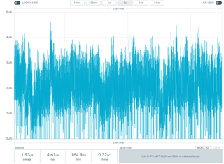

Hello I'm trying to get the lower consumption with this EvK in power off mode. I was expecting around 0.5uA but the minimum I get is 1.8uA ~ 2uA.
The measure has been done with a nRF Power Profiler and an SMU Keithley 2450.

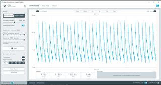

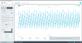

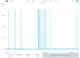

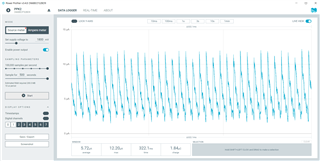

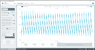

Here some screenshots from the Power Profiler Kit:
Thanks in advance Slight smile

    Either way, there isn't really anything such as a peripheral that uses 5 µA. The excess current could for example be due to your measurement setup. Could provide a plot that shows the current?

  • Hi there,
    I discussed your plots along with my own measurements with a colleague, and we suspect that the extra current might be consumed by the peripheral power domain.
    In short, you can try 2 things:
    1. Disable UART by setting NRF_LOG_ENABLED = 0 in your sdk_config.h file.
    2. Modify the code in main.c so that it uses GPIO PORT event instead of GPIO IN_EVENT. See this thread.
    Enabling logging or using GPIO IN_EVENT will turn on the peripheral power domain which seems to be consuming the extra current. Could you try to implement these suggestions?
