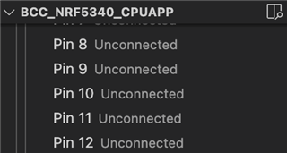

    It is possible that P0.10 is assigned to the Network core for its UART instance, see this thread and this file.
    Jørgen
  • It is possible that P0.10 is assigned to the Network core for its UART instance

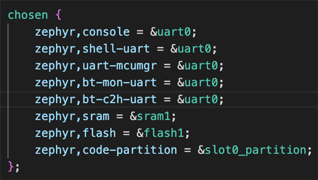

    As you told me, I checked the network core and found the child image 'hci_rpmsg' uses pin P0.10 for the UART instance and zephyr functions.

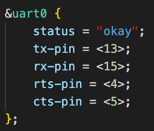

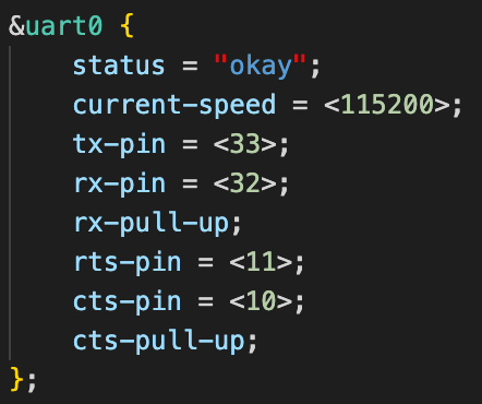

     As I need to use P0.10, P0.11, and P1.1 for other purposes, I modified the cpu_net overlay file like following
     The overlay file is located in the sdk/zephyr/samples/bluetooth/hci_rpmsg
     However, the SPI data still not coming via P0.10...
  • I also disabled CONFIG_LOG of the network core according to this thread but it still not works
