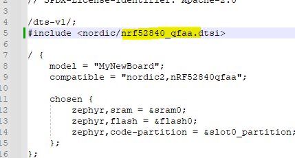

  • Hi Chris,
    Good timing. We actually have nrf52840_qfaa.dtsi file added in NCS v2.5.0 release just a week ago Slight smile
    Please check \zephyr\dts\arm\nordic

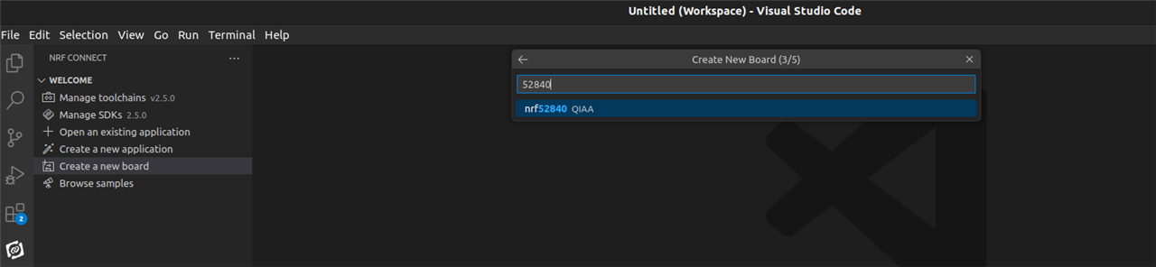

  • I have upgraded to 2.5.0. When I go into the NRF Connect tab in VS Code and select "Create a New Board", I enter '52840' for the processor type, but I am still seeing the only option listed as nRF52840 QIAA. I don't see a QFAA package option listed.
    no_qfaa_option
    Are there additional steps I need to do to create a new board in VS Code based on the nRF52840 QFAA with SDK 2.5.0?
  • Hi Chris,
    It seems that we haven't updated the list inside VSCode.
    However you can still select the chip manually.
    What you can do is to still select the QIAA when you create a new board in VSCode.

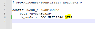

    Then you can edit the following files to change from QFAA to QIAA:
    Your .dts file:
    Kconfig.board:
    Your _devconfig:
    After that you should be able to compile with QFAA variant.
