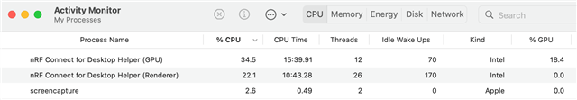

  • I don't think this installation is completing properly.  I've tried 3 times:
    1. Launch nRF Connect for Desktop
    2. Enter Toolchain Manager
    3. Install 2.0.0
    4. <hangs at memfault stage>
    5. Quit
    6. Launch nRF Connect for Desktop
    7. Enter Toolchain Manager
    8. Remove 2.0.0 environment
    9. Quit
    10. Repeat the process
    The hang in #4 happens every time.  It's not a fluke.
    It is the git process that is getting wedged:
    # ps auxwww | grep memfault
    admin 21905 0.0 0.0 34421664 5108 ?? S 4:25PM 0:00.03 git fetch -f --tags -- github.com/.../memfault-firmware-sdk 0.29.1
    lsof shows that it doesn't have any sockets open, which means it's not caused by a network connection getting stalled:
    # lsof -n | grep ^git
    git 21905 admin cwd DIR 1,15 96 21527642 /opt/nordic/ncs/v2.0.0/modules/lib/memfault-firmware-sdk
    git 21905 admin txt REG 1,15 3033288 21431331 /opt/nordic/ncs/toolchains/v2.0.0/Cellar/git/2.32.0_1/bin/git
    git 21905 admin txt REG 1,15 4376160 21466510 /private/var/db/oah/0b833e18ecef0e9978fe7e49ac779dfffc2d441c9d93d8ab63ab224abc515f59/e20bb4c3db2bbdcbfffe26d96bb986c6556a61d8e3531c6d1580422d993a51ca/git.aot
    git 21905 admin txt REG 1,15 233056 1152921500312788000 /usr/libexec/rosetta/runtime
    git 21905 admin txt REG 1,15 381680 19267166 /Library/Apple/usr/libexec/oah/libRosettaRuntime
    git 21905 admin txt REG 1,15 59156 21449869 /opt/nordic/ncs/toolchains/v2.0.0/Cellar/gettext/0.21/lib/libintl.8.dylib
    git 21905 admin txt REG 1,15 59416 21466514 /private/var/db/oah/0b833e18ecef0e9978fe7e49ac779dfffc2d441c9d93d8ab63ab224abc515f59/48e5f74d07549aebd9346c19f80c7edb4b028f1213ec387215e9f9600c215d27/libintl.8.dylib.aot
    git 21905 admin txt REG 1,15 46864 19266539 /Library/Preferences/Logging/.plist-cache.DrKORzJo
    git 21905 admin txt REG 1,15 572112 21439663 /opt/nordic/ncs/toolchains/v2.0.0/Cellar/pcre2/10.37_1/lib/libpcre2-8.0.dylib
    git 21905 admin txt REG 1,15 662792 21466512 /private/var/db/oah/0b833e18ecef0e9978fe7e49ac779dfffc2d441c9d93d8ab63ab224abc515f59/2ab2f015a791b7cda2f74d3b5043c2115027930855e009667b9e5a2fd45247e8/libpcre2-8.0.dylib.aot
    git 21905 admin txt REG 1,15 142696 21527681 /opt/nordic/ncs/v2.0.0/modules/lib/memfault-firmware-sdk/.git/objects/pack/pack-ea43bc9869bb0c8dd373be2ebf1fa3e7048aa424.idx
    git 21905 admin txt REG 1,15 1994288 21527680 /opt/nordic/ncs/v2.0.0/modules/lib/memfault-firmware-sdk/.git/objects/pack/pack-ea43bc9869bb0c8dd373be2ebf1fa3e7048aa424.pack
    git 21905 admin txt REG 1,15 2160656 1152921500312781597 /usr/lib/dyld
    git 21905 admin txt REG 1,15 812723 19297118 /private/var/db/oah/0b833e18ecef0e9978fe7e49ac779dfffc2d441c9d93d8ab63ab224abc515f59/51d62da53a337e9df4a5182e605fa09682db158d34d7f285356069d2009afcf7/dyld.aot
    git 21905 admin 0u unix 0x5d449eafc79ecf1b 0t0 ->0x5d449eafc79ece53
