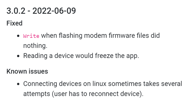

    Although, I seem to have gotten things to work with the dongle. There was a new release for the programmer app v3.0.2, and when I updated the app everything worked properly. It seems as though this was a known bug since the release notes mention issues with the "write" feature:
    So to any others who are experiencing this issue, try updating to a newer programmer version as this has worked for me. If any other issues come up relating to this topic, I will post them in this thread. Thank you for helping me with this Einar.
