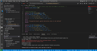

  • After searching different Questions and Answers in Devzone, I came to the point , that I have to change the Device Tree by including Overlay file in the root folder of the main function. I have made a simple program to blink an LED connected to the GPIO pin 22 which is declared as CLK.
    Refernce
    Device Tree Overlay Program Reference
    I have included the main.c function and the overlay file below:
    main.c
    #include <zephyr.h>
    #include <device.h>
    #include <devicetree.h>
    #include <drivers/gpio.h>
    /* Increase the main thread sleep time from 100ms to 1 second  */
    #define SLEEP_TIME_MS 1000
    //Defining GPIO pins
    #define CLK_NODE DT_ALIAS(gpiocus0)
    #if DT_NODE_HAS_STATUS(CLK_NODE, okay)
    #define CLK DT_GPIO_LABEL(CLK_NODE, gpios)

    The screenshot of my VS Code workspace:
    Hardware setup and wiring diagram :
    This is my hardware setup to blink an LED connected to GPIO pin no : 22.
    If you notice any error in my wiring circuit , Please notify that.
    I have Pristine build the above code without any errors.But , when I flash it in thw nRF52840 DK board, I won't get any output. I connected an LED at GPIO pin 22 with required resistor. I don't know what am I missing?Can you tell me how can I solve this problem?
    Ultimately I have to control the 4 Digit Display using these two GPIO pins. If you have idea to do that, Please tell me how can I achieve that.
    Thankyou.
    -Vicky

    	const struct device *i2c_dev;
    	k_sleep(K_SECONDS(1));
    	printk("Starting i2c scanner...\n");
    	i2c_dev = device_get_binding(I2C_DEV);
    	if (!i2c_dev) {
    		printk("I2C: Device driver not found.\n");
    		return;
    	uint8_t error = 0u;
    	i2c_configure(i2c_dev, I2C_SPEED_SET(I2C_SPEED_STANDARD));
    	printk("Value of NRF_TWIM1->PSEL.SCL: %d \n", NRF_TWIM0->PSEL.SCL);
    	printk("Value of NRF_TWIM1->PSEL.SDA: %d \n", NRF_TWIM0->PSEL.SDA);
    	//printk("Value of NRF_TWIM3_NS->FREQUENCY: %d \n",NRF_TWIM3_NS->FREQUENCY);
    	//printk("26738688 -> 100k\n");
    	for (uint8_t i = 4; i <= 0x77; i++) {
    		struct i2c_msg msgs[1];
    		uint8_t dst = 1;
    		/* Send the address to read from */
    		msgs[0].buf = &dst;
    		msgs[0].len = 1U;
    		msgs[0].flags = I2C_MSG_WRITE | I2C_MSG_STOP;
    		error = i2c_transfer(i2c_dev, &msgs[0], 1, i);
    		if (error == 0) {
    			printk("0x%2x FOUND\n", i);
    		else {
    			//printk("error %d \n", error);
    	printk("Scanning done\n");
    Basically, I changed the #include that included the nrf9160 header file (line 1), Then I changed line 45 and 46, which were hardcoded for the I2C_3.

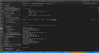

  • Thankyou for you quick reply , Edvin. As your recommendation , I will use I2C Communication to control the TM1637 Display. Your way of explaining things is really great. I can easily understand the steps and procedure , which I have to follow to do my project working from your reply.
    As you said, I used the nRF52840 DK with the I2C_Scanner sample from the Github .I downloaded the file from the GitHub and changed the
    overlay file as follows:
    nrf52840dk_nrf52840.overlay
    &i2c0 {
    	status = "ok";
    	sda-pin = <27>;
    	scl-pin = <26>;
    	clock-frequency = <I2C_BITRATE_STANDARD>;
    I renamed the overlay file as nrf52840dk_nrf52840.overlay.
    I removed the CONFIG_I2C_3=y from the configuration file as well.Then I used the code given by you in the main.c file and compiled it.It build successfully.When I connected my display to the SCL, SDA pins it does't give any address at the Output terminal.

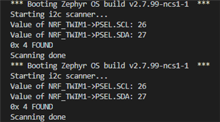

    Output Terminal:

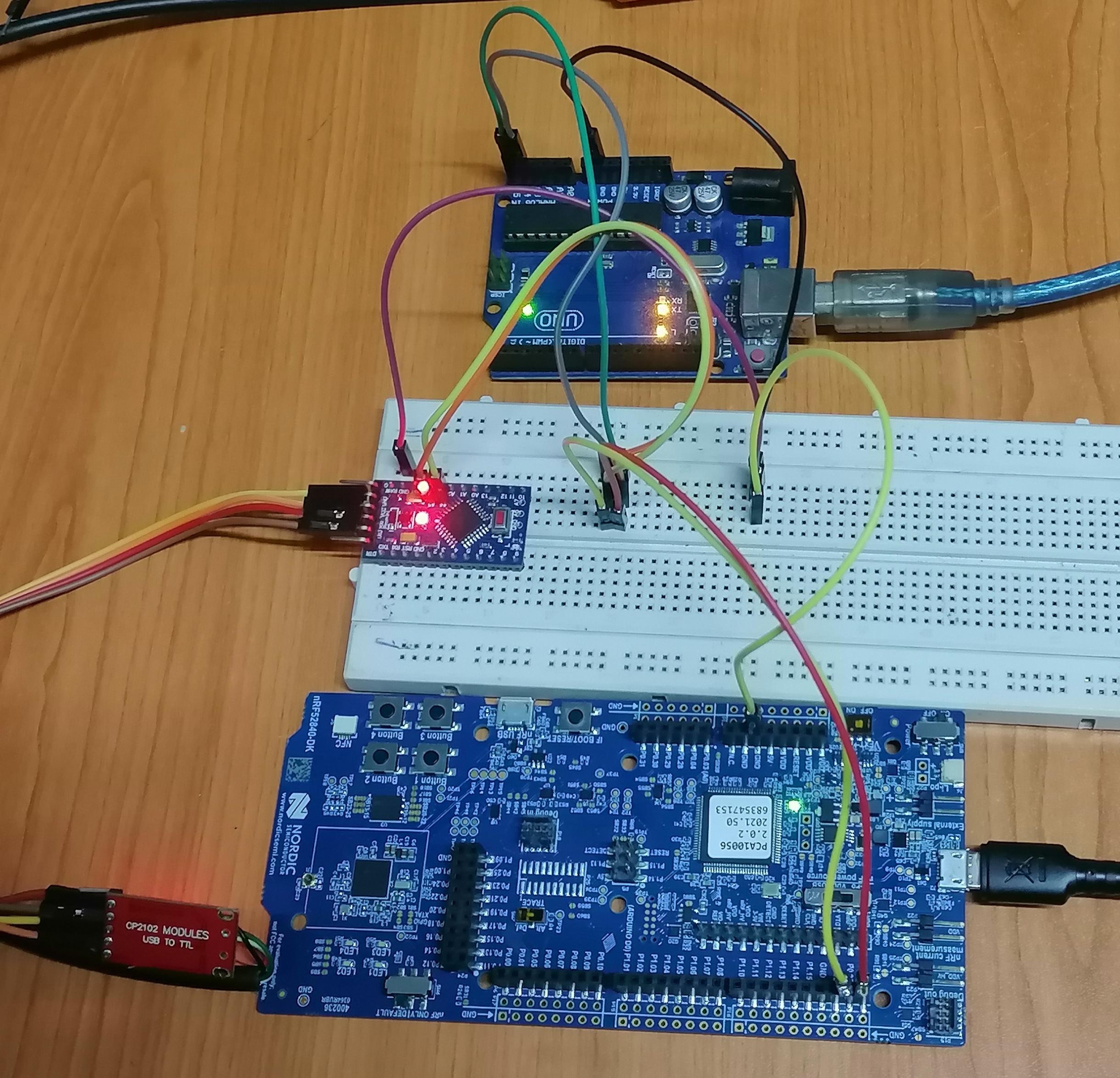

    As for the extra checking, I use two Arduino boards which connect between them through I2C communication and send and receive data between them.
    Then, I used the live I2C communication to scan the address from the nRF52840 DK.
    My Test Setup:
    Even at this condition, it won't give any address of the I2C modules(Arduino Uno & Arduino Pro Mini)
    I even the changed the Serial communication baud rate to 115200 on the two Arduino modules for detection of the addresses. But, I don't get any address at this state also.
    I don't know what will be the problem in this. Can you please tell me how to solve this problem?
    Software:
    I program the boards using VS Code, nRF connect Extension.
    Thankyou.
    -Vicky.

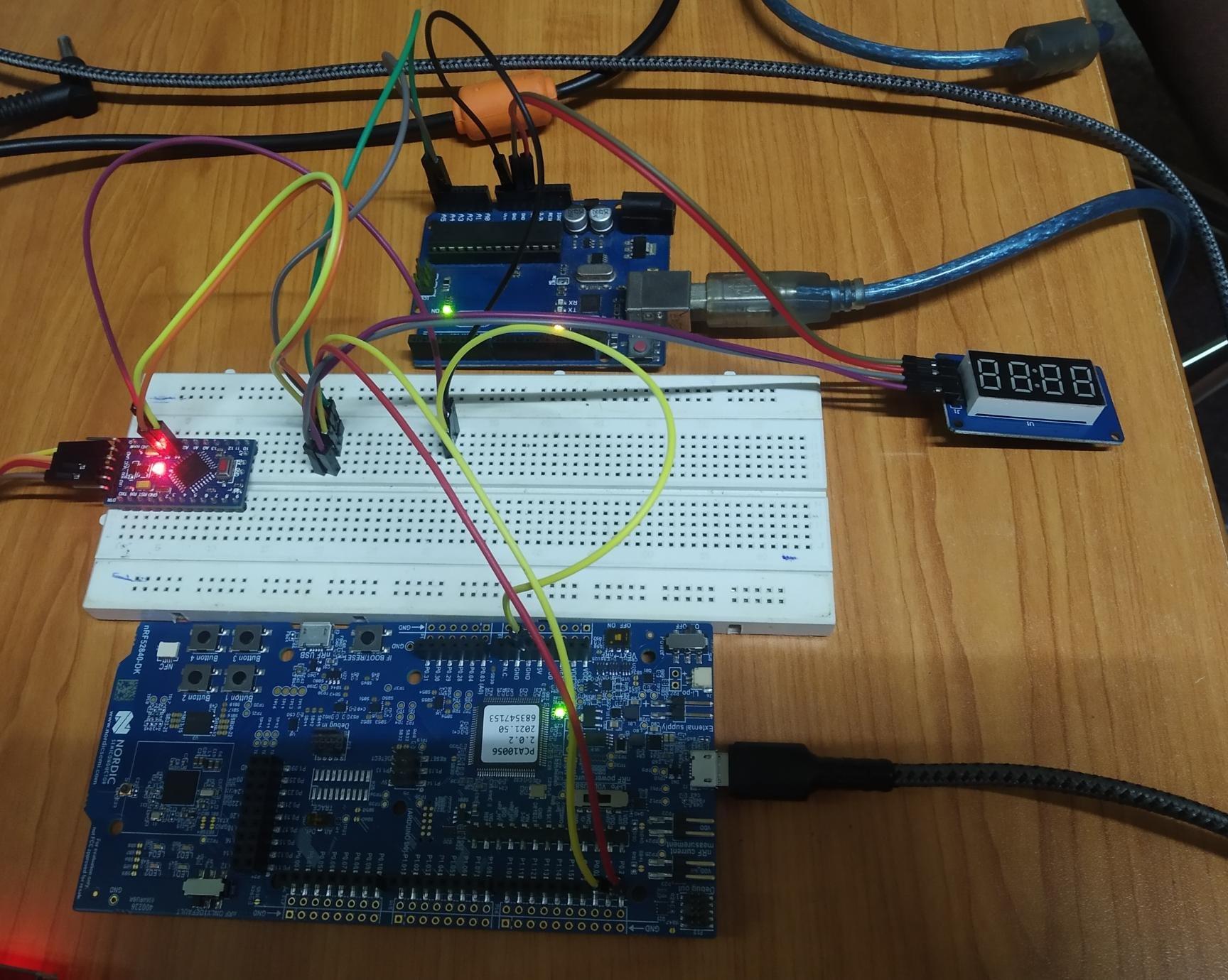

  • Really Sorry.I wronlgy connected the SCL, SDA pins of the nRF52840 DK to the other SCL, SDA pins. After correct connection, I get to found the adress of the live I2C
    commuication as 0x4. Then, I try to connect the TM1637 display to the ongoing live I2C Connection. After connecting that, I get to found more number of addresses(above 25)
    at the Output Terminal. But, when I try to connect that Display directly to the DK which was running I2C_Scanner program, it won't detect that display.
    It gets detected when a live I2C connection flows along with it only.
    My Setup:
    Terminal Output:
    When Arduino live I2C connection is Ongoing:
    When TM1637 connected to the live I2C Connection:

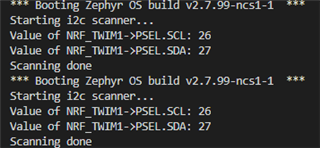

    When TM1637 alone connected to DK:
    What will be the problem ?
