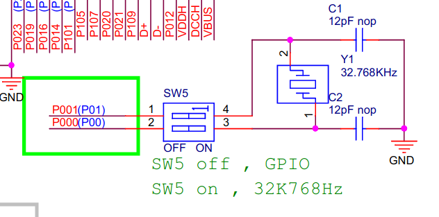

I also have made internal clock related changes for BT 840: https://devzone.nordicsemi.com/f/nordic-q-a/58956/softdevice-not-working-on-bt840-based-custom-board
#define NRF_SDH_CLOCK_LF_SRC 0
#define NRF_SDH_CLOCK_LF_RC_CTIV 16
#define NRF_SDH_CLOCK_LF_RC_TEMP_CTIV 2
#define NRF_SDH_CLOCK_LF_ACCURACY 1
This same example works on nRF Development Kit but does not work on BT840. I was wondering how does the underlying hardware affecting the thread operation? Kindly let me know if there is any information on this.
