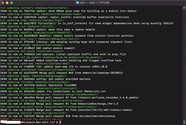

I keep getting an error when trying to do a west update with regards to the LC3 codec.  This is on my Mac Mini M1.  I know my credentials are valid, as I can log into Github and view the LC3 repo via the browser.
I used the following 2 commands to update the SDK with the LC3 codec:
west config manifest.group-filter +nrf5340_audio
west update
I have tried with and without admin privilege's.

    Last login: Fri Jun 17 10:41:29 on ttys001
    michaelbester@Michaels-Mac-mini ~ % export PATH=/opt/nordic/ncs/toolchains/v2.0.0/bin:/opt/nordic/ncs/toolchains/v2.0.0/usr/bin:/opt/nordic/ncs/toolchains/v2.0.0/usr/local/bin:/opt/nordic/ncs/toolchains/v2.0.0/opt/bin:/opt/nordic/ncs/toolchains/v2.0.0/opt/nanopb/generator-bin:/opt/nordic/ncs/toolchains/v2.0.0/opt/zephyr-sdk/arm-zephyr-eabi/bin:$PATH
    michaelbester@Michaels-Mac-mini ~ % export GIT_EXEC_PATH=/opt/nordic/ncs/toolchains/v2.0.0/Cellar/git/2.32.0_1/libexec/git-core
    michaelbester@Michaels-Mac-mini ~ % export GIT_TEMPLATE_DIR=/opt/nordic/ncs/toolchains/v2.0.0/Cellar/git/2.32.0_1/share/git-core/templates
    michaelbester@Michaels-Mac-mini ~ % export ZEPHYR_SDK_INSTALL_DIR=/opt/nordic/ncs/toolchains/v2.0.0/opt/zephyr-sdk
    michaelbester@Michaels-Mac-mini ~ %                 cd /opt/nordic/ncs/v2.0.0
    michaelbester@Michaels-Mac-mini v2.0.0 %                 clear
    michaelbester@Michaels-Mac-mini v2.0.0 % west config manifest.group-filter +nrf5340_audio
    michaelbester@Michaels-Mac-mini v2.0.0 % west update
    === updating zephyr (zephyr):

    === updating sdk-lc3 (modules/lib/lc3):
    --- sdk-lc3: fetching, need revision c47d9ee21c9cd8626a903c2e2f0c80c0920a1eb8
    Username for 'https://github.com': besterm
    Password for 'https://[email protected]':
    remote: Support for password authentication was removed on August 13, 2021. Please use a personal access token instead.
    remote: Please see https://github.blog/2020-12-15-token-authentication-requirements-for-git-operations/ for more information.
    fatal: Authentication failed for 'https://github.com/nrfconnect/sdk-lc3/'

    ERROR: update failed for project sdk-lc3

  • Thank you for providing the information.
    I see from your log that it says the authentication failed for the sdk-lc3 repository.
    Could you perhaps try to run the update from the nRF Connect terminal in VSC - available in VSC by pressing ctrl + shift + p and searching for "shell"? This will allow you to add your github authentication to your VSC profile, which might bypass this problem.
    Try this, and let me know if it does not resolve your issue.
    Karl
  • Your suggestion worked.  I was able to get the repo and build the audio sample project.  Not sure why I doesn't work using the terminal from within the NRF tool manager.  At least I have a solution.  Thanks.
  • I'm happy to hear that you now have got it up and running, great! :)
    I discussed the root cause of this with some colleagues and they told me that the NCS repositories as default does not support password authentication, which necessitates using personal access tokens instead.
    Please do not hesitate to open another ticket if you should encounter any other issues or questions in the future.
