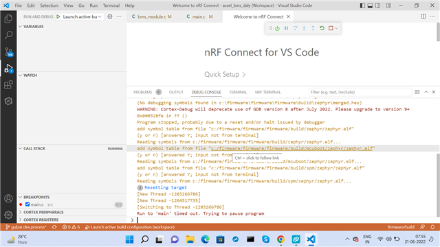

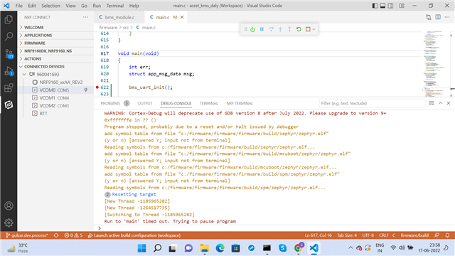

Earlier I created a project in SES for nRF5340. The simulation and debugging was quiet simple and easy to find the fatal errors, run time errors etc. Same features are not so well present in VS.  I opened asset_tracker_v2 project in VS. When clicked RUN->start debug, the terminal and Debug outputs are shown in images. I added a custom function to main() and set a breakpoint there.  The debugger is halted. I observed that step over and step into options also are not fade as shown in third image. If there are any run time issues / errors, where are these displayed ?

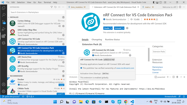

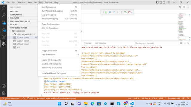

  • I checked that extension is installed (See image). How to use ?? I tried by launching the icon on left side panel . Then the Debug CONSOL and terminal messages are as shown in 2nd and 3rd images.
    1. What does "Run to Main "Time out" mean"  in debug CONSOL and why this ?

    We recommend that you follow either the automatic installation guide using the toolchain manager or the manual installation guide when setting up your nRF Connect Software Development Kit (nRF Connect SDK). I will also recommend that you take the NCS fundamentals course to get familiar with how the SDK is set up and how to create and modify applications in the SDK.
    Furthermore you will need to install nrf Command line tools (please se the step in the tutorial before installing) which useful tools required for debugging and using our tools.
    The debug session times out due to an error in either your application or with your SDK setup. Did you have "Enable debug options" selected when generating the build configuration? Please try to generate the build configuration with this option unchecked after ensuring that your development environment is properly configured

  • I unchecked Enable debug options in build configurations, then build and compilation was successful. The Debugger launched properly and entered to Main thread. But, what may be the reasons not to work when Enable debug options is checked ?
