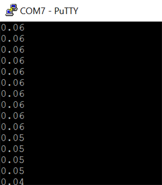

I'm sending values over ble. On the client side I opened an serial monitor. Everything seems fine. The values are received in the right way.

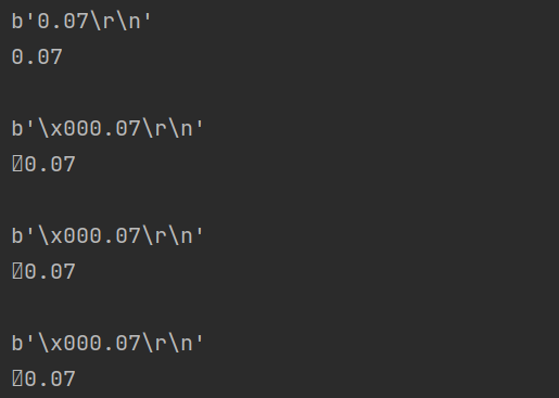

But when I try to read the serial port in python it says:
There is an random character, what isn't visible in the serial monitor(putty).

  • I did watched the data on python.
    In the 2th, 3th etc it add an \x sequence. Is this something on the client side of my software?
